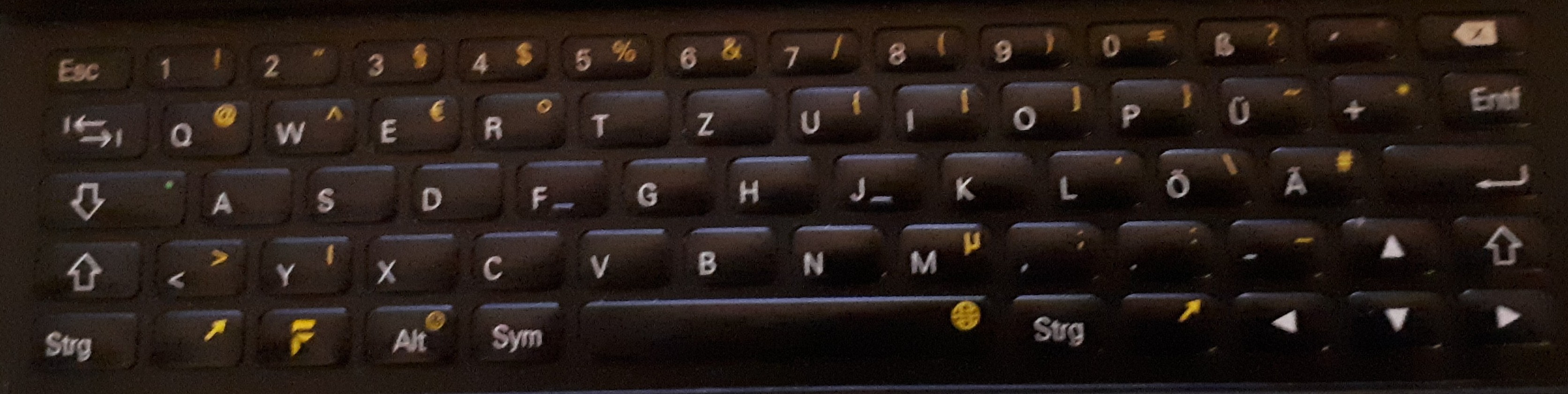

Wunder Wungiel 9 Posted June 11, 2023 Share Posted June 11, 2023 Hi. I have FxTec Pro1, QWERTZ variant. Layout is like this: Of course default layout is "shifted", i.e. typing "w" gives "q", "e" gives "w" etc. These commands: dconf write /desktop/lipstick-jolla-home/model \"fxtecpro1\" dconf write /desktop/lipstick-jolla-home/layout \"de\" Make the layout "working". I.e non-shifted again. But I would like to have Polish (Programmers) layout on QWERTZ. I.e. "y" instead of "z". Sym + L = Ł. Is that possible? Quote Link to post Share on other sites
EskeRahn 5,608 Posted June 13, 2023 Share Posted June 13, 2023 On 6/11/2023 at 8:04 AM, Wunder Wungiel said: But I would like to have Polish (Programmers) layout on QWERTZ. I.e. "y" instead of "z". Sym + L = Ł. Is that possible? Have a look at FinQwerty, (already including a layout for Polish). Open source and fully customisable. (Also available in the Android Market) Quote Link to post Share on other sites
Hook 3,385 Posted June 13, 2023 Share Posted June 13, 2023 5 hours ago, EskeRahn said: Have a look at FinQwerty, (already including a layout for Polish). Open source and fully customisable. (Also available in the Android Market) Except, I don't think he's on stock. Under his user name he lists LOS 20, but judging from the commands he posted and the thread this is posted in, I would say he's on Sailfish. 😉 1 Quote Link to post Share on other sites
Wunder Wungiel 9 Posted June 16, 2023 Share Posted June 16, 2023 O Quote Link to post Share on other sites
Wunder Wungiel 9 Posted June 16, 2023 Share Posted June 16, 2023 Oh hi again. Yes, I am on Sailfish. I did what I wanted in the end. I manually configured XKB layout (US), having Unicode codes, QWERTY shifted, QWERTZ non-shifted and QWERTY non-shifted on eyes. I enjoy Polish Programmers layout now. For AlienDalvik I was able to make standard US only, attaching a ZIP file for Key Mapper (requires Shizuku) Sailfish Pro1 Android US Layout.zip 1 Quote Link to post Share on other sites
