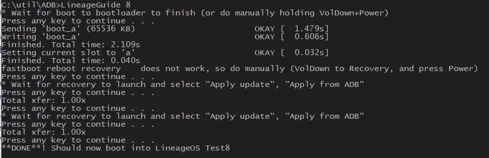

EskeRahn 5,598 Posted March 7, 2020 Share Posted March 7, 2020 I tried to simplify the flashing process so I did not need to fiddle with the devices buttons, and remember/read as much If I do this at the bootloader fastboot reboot recovery the response looks sensible Rebooting into recovery OKAY [ 0.001s] Finished. Total time: 0.003s BUT despite saying otherwise it boots into normal and not recovery, so can not simplify that step So now my script for lineage+gapps is like this @ECHO off if %1.==. goto :EOF ECHO * Wait for boot to bootloader to finish (or do manually holding VolDown+Power) adb reboot bootloader pause fastboot flash boot_a LineageOS\lineage-16.0-pro1-test%1-boot.img fastboot --set-active=a ECHO fastboot reboot recovery does not work, so do manually (VolDown to Recovery, and press Power) pause ECHO * Wait for recovery to launch and select "Apply update", "Apply from ADB" pause adb sideload LineageOS\lineage-16.0-pro1-test%1.zip pause adb reboot recovery ECHO * Wait for recovery to launch and select "Apply update", "Apply from ADB" pause adb sideload LineageOS\MindTheGapps-9.0.0-arm64-20190615_031441.zip pause adb reboot ECHO **DONE** Should now boot into LineageOS Test%1 Obviously the path should be adjusted to where you stored the download images The interaction looks like this 2 Quote Link to post Share on other sites
