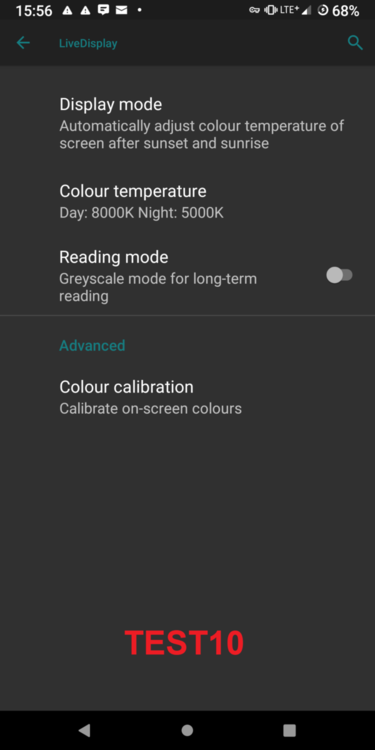

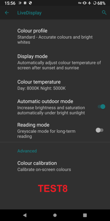

EskeRahn 5,598 Posted March 10, 2020 Share Posted March 10, 2020 Just curious, why are the options in LiveDisplay reduced with Test10 compared to Test8? (do not recall how it was on Test9) Quote Link to post Share on other sites

tdm 2,322 Posted March 10, 2020 Author Share Posted March 10, 2020 58 minutes ago, EskeRahn said: Just curious, why are the options in LiveDisplay reduced with Test10 compared to Test8? (do not recall how it was on Test9) Possibly this commit? I got it from another device while I was trying to get things working, and then I deleted it when I saw that 1+5/5t does not have it. I am not sure if it should be present or not. 1 Quote Link to post Share on other sites

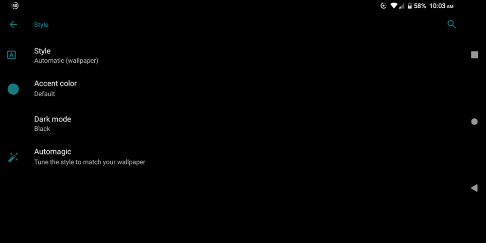

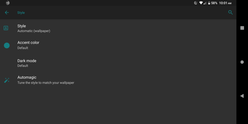

Craig 1,435 Posted March 10, 2020 Share Posted March 10, 2020 (edited) For what its worth, substratum works on stock pie for dark theme, as reported by @elvissteinjr It seems to me I'm already pretty dark under Lineage tho, where are you seeing all this white? Lineage settings menu backgrounds all dark... you can set your own launcher backgrounds (I use nova and set both the wallpaper and app drawer pure black, and changed the search background from white to charcoal)... I used dark theme youtube vanced... discord has dark theme... riot is dark by default... even play store black background... edit: there's even a setting for Dark Mode that I hadn't even tried yet, about to see what it does to change it to black Now true black settings menu, cool Edited March 10, 2020 by Craig 1 Quote Link to post Share on other sites
