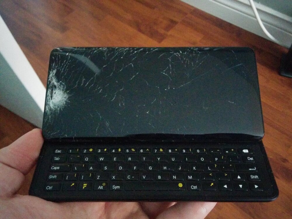

archseraphim 50 Posted September 4, 2020 Share Posted September 4, 2020 Going to assume my repair options are nil. Would've like to have it longer, but oh well. 3 Quote Link to post Share on other sites
Wheeljack 212 Posted September 4, 2020 Share Posted September 4, 2020 People here have ordered replacement screens for about $50 on aliexpress. 3 4 Quote Link to post Share on other sites
archseraphim 50 Posted September 4, 2020 Author Share Posted September 4, 2020 Good to know! Just found a link in another thread and ordered the screen. Hopefully all goes well! 3 Quote Link to post Share on other sites
zurvan2 125 Posted September 4, 2020 Share Posted September 4, 2020 You can also order a replacement screen assembly directly from support, but it's more expensive. It is a simple process to replace, though. 1 Quote Link to post Share on other sites

Doktor Oswaldo 916 Posted September 8, 2020 Share Posted September 8, 2020 On 9/4/2020 at 3:51 PM, atfrase said: $50? Wow; support quoted me 150 GBP. Yeah but support sold you the whole upper part of the phone, not just the screen. 2 1 Quote Link to post Share on other sites
atfrase 10 Posted September 8, 2020 Share Posted September 8, 2020 1 hour ago, Doktor Oswaldo said: Yeah but support sold you the whole upper part of the phone, not just the screen. Ah, I see (and thanks for finding the link, @OKSun). I imagine the replacement of the screen only would be much more difficult, though; in the instructions support sent me for the whole upper unit, it was just five screws and a ribbon cable. I wonder also if a screen-only replacement would suffice in my case; I have not only cracked glass but a permanent solid magenta line in one whole column of pixels. It does say "touch screen + LCD display" but I'm not familiar enough with this kind of hardware to judge whether I might have damage to some additional component(s) underneath. Quote Link to post Share on other sites

PanicBrothers 66 Posted September 8, 2020 Share Posted September 8, 2020 I ordered in the past this: https://a.aliexpress.com/_d8cjaSP Fits perfect and all good. Regards Panic Brothers 2 Quote Link to post Share on other sites
atfrase 10 Posted September 8, 2020 Share Posted September 8, 2020 2 hours ago, PanicBrothers said: I ordered in the past this: https://a.aliexpress.com/_d8cjaSP Fits perfect and all good. Regards Panic Brothers How difficult was it to actually perform the replacement? Did you follow a guide or video? Quote Link to post Share on other sites
PanicBrothers 66 Posted September 9, 2020 Share Posted September 9, 2020 Good morning, I did not by myself. I went in a professional Mobile Care Center. It took 30 Euro and all is done with 2 years warranty. For me this are only phones and things to make my life easier.This is the reason why I sell it after the repair. You can spend hours and hours to get something to work on the Pro1 and come here for discussion. I don't need a new Love to play with, I want a good working product 😉 1 Quote Link to post Share on other sites

atfrase 10 Posted September 26, 2020 Share Posted September 26, 2020 On 9/15/2020 at 3:37 PM, benoitjeffrey said: I used to like the moto Z for this reason, they put a "shatter proof screen" thick plastic touch screen but it was prone to scratch. so adding a tempered glass and keeping some in spare was perfect from my point of view. Aside of this, I just replaced my Pro1 LCD with a $69 elephone, it's not easy like replacing the lcd assembly but it's pretty easy vs a lot of other phone i done in the past. I remember taking apart my Motorola Milestone, it needed to be disassembled from the bottom all the way up to the touch screen, so yes pretty easy job to do on the pro1 Any advice or guide on how to do this replacement? I have the Elephone U Pro replacement part from aliexpress but I'm unsure how best to get the original screen off. 1 Quote Link to post Share on other sites

Hook 3,304 Posted September 27, 2020 Share Posted September 27, 2020 4 hours ago, atfrase said: Any advice or guide on how to do this replacement? I have the Elephone U Pro replacement part from aliexpress but I'm unsure how best to get the original screen off. I believe F(x)Tec has a support video for changing out the screen. I would imagine they would share it with you even if they didn't send you the screen. Worth contacting them. 1 Quote Link to post Share on other sites
Slion 1,201 Posted September 27, 2020 Share Posted September 27, 2020 16 hours ago, atfrase said: Any advice or guide on how to do this replacement? I have the Elephone U Pro replacement part from aliexpress but I'm unsure how best to get the original screen off. Remove the screen assembly first, there are five screws at the back of the display underneath stickers. Unhook the flexible flat cable. Then I believe you need to pry apart the screen itself from the assembly's frame. I believe it is just glued in place. There must be a small tool included with your replacement screen to help with that. Quote Link to post Share on other sites
FlyingAntero 871 Posted September 28, 2020 Share Posted September 28, 2020 (edited) On 9/26/2020 at 11:18 PM, atfrase said: Any advice or guide on how to do this replacement? I have the Elephone U Pro replacement part from aliexpress but I'm unsure how best to get the original screen off. These guides might be helpful: Teardown: https://gelraen.github.io/fxtec-pro1-teardown/ Screen replacement: https://community.fxtec.com/topic/2586-spare-parts/page/2/?tab=comments#comment-40911 BTW: Are you able to share the instructions from the support (F(x)tec)? EDIT: Or is it this one? There are instructions how to disassembly screen panel with heat gun. https://matland.be/pro1disassembly.pdf Edited September 28, 2020 by FlyingAntero 4 Quote Link to post Share on other sites
VaZso 1,999 Posted September 28, 2020 Share Posted September 28, 2020 On 9/26/2020 at 10:18 PM, atfrase said: Any advice or guide on how to do this replacement? I have the Elephone U Pro replacement part from aliexpress but I'm unsure how best to get the original screen off. I have just replaced my screen in my Pro1 yesterday. The instructions @FlyingAnterolinked are good - you will need a heat gun (the one which is not looks like a hair dryer but a smaller, better controllable unit). You should heat up the screen edges - the disassembly guide suggest 160 degree Celsius, ensure you don't really exceed it, so a simple hair dryer is really not good (also because of excessive amount of air and uncontrolled temperature). You will need a little bit of patience but the display will come out. Then you should clean the frame itself and you will need something which can be used to glue the new screen in a way it may be removed later but still holds well. So don't use any epoxy or "super glue" like cyanoacrylate for this purpose. You may have received some useful materials together with the new screen for this purpose. The process itself is straightforward but you need a proper heat gun and maybe some experience. 1 2 Quote Link to post Share on other sites
atfrase 10 Posted September 28, 2020 Share Posted September 28, 2020 On 9/27/2020 at 8:04 AM, Slion said: Remove the screen assembly first, there are five screws at the back of the display underneath stickers. Unhook the flexible flat cable. Then I believe you need to pry apart the screen itself from the assembly's frame. I believe it is just glued in place. There must be a small tool included with your replacement screen to help with that. 4 hours ago, FlyingAntero said: These guides might be helpful: Teardown: https://gelraen.github.io/fxtec-pro1-teardown/ Screen replacement: https://community.fxtec.com/topic/2586-spare-parts/page/2/?tab=comments#comment-40911 BTW: Are you able to share the instructions from the support (F(x)tec)? EDIT: Or is it this one? There are instructions how to disassembly screen panel with heat gun. https://matland.be/pro1disassembly.pdf 3 hours ago, VaZso said: I have just replaced my screen in my Pro1 yesterday. The instructions @FlyingAnterolinked are good - you will need a heat gun (the one which is not looks like a hair dryer but a smaller, better controllable unit). You should heat up the screen edges - the disassembly guide suggest 160 degree Celsius, ensure you don't really exceed it, so a simple hair dryer is really not good (also because of excessive amount of air and uncontrolled temperature). You will need a little bit of patience but the display will come out. Then you should clean the frame itself and you will need something which can be used to glue the new screen in a way it may be removed later but still holds well. So don't use any epoxy or "super glue" like cyanoacrylate for this purpose. You may have received some useful materials together with the new screen for this purpose. The process itself is straightforward but you need a proper heat gun and maybe some experience. Thanks for all these resources! I understand now the process, though I'm undecided whether I'll attempt it; I may just give in and order the full display unit replacement from Fxtec, which looks to be a much simpler replacement. 1 Quote Link to post Share on other sites
archseraphim 50 Posted September 28, 2020 Author Share Posted September 28, 2020 Just did my replacement as well. Didn't have a heat gun and just brute forced the old panel off, and while it worked for me it is a process I can't honestly recommend. Does the version on aliexpress with frame also work with the pro1? If so that would eliminate the need for that step. Aside from that it all went very smoothly. New display is indistinguishable from my original as far as I can tell. 1 Quote Link to post Share on other sites
