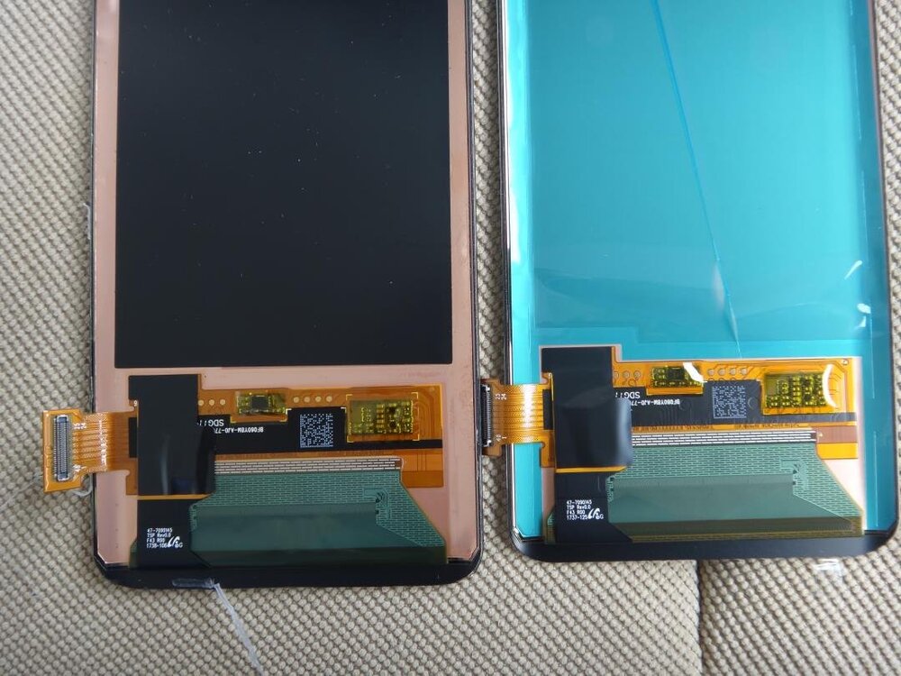

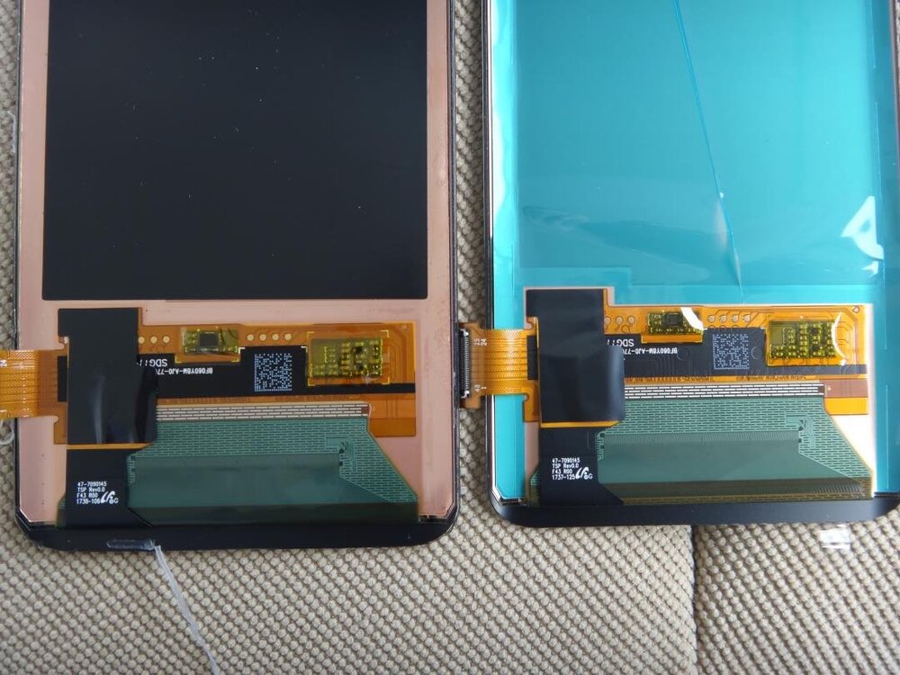

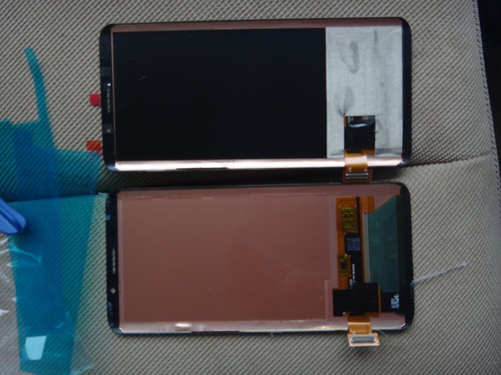

DieBruine 397 Posted May 26, 2021 Share Posted May 26, 2021 (edited) So I replaced my screen. All in all it took me about an hour I think, spread over three days. First I removed the screen with the help of my trusty hairdryer. I bought this hairdryer a couple of years ago specific for these kind of 'operations' (came with a nozzle). I heated up one (long) side and put my nail in between the gap (screen and frame). I repeated this on the other side. After I removed the glue residue from the frame I transferred the black and silver stickers from the old screen to the new screen. No idea why, but I just did, assuming there moust be a reason FxTec places those stickers. Then I applied the glue, included in the Ali-order, to the frame and stuck the screen to the frame. Afterwards I put a bottle of whisky on the screen to apply pressure and let the glue dry for at least 48 hours. By the way, I can see absolutely NO difference in hardware (which is why I included the pictures side-by-side). That was two days ago. I just re-assembled my phone and ofcourse the digitizer doesn't function properly (outer edges don't register input). So I had to go back to stock to update the firmware in the screen. The outer edges now respond to input/ touch. Just flashed LoS 20210524 and MtG and of course it doesn't boot. So I'm cycling through slot a and b now. Forgot to wipe after flashing to LoS, I assumed going back to stock was enough. Wipe/ erase system did the trick. Replacing the screen is something anyone can do. The only thing that can happen is that it can get messy due to the glue. I would advise you first apply the glue, press the screen on the frame, apply some sort of pressure, and after a couple of hours wipe the glue of the frame with your fingers. Actually I would describe it as rubbing the glue residue from the frame to the screen. I left the film on so I'm not worried the glue won't come off. Edited May 26, 2021 by DieBruine 3 7 Quote Link to post Share on other sites

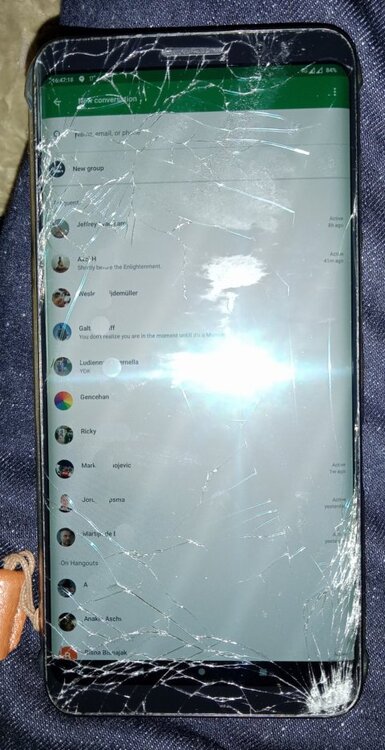

DieBruine 397 Posted June 23, 2021 Share Posted June 23, 2021 (edited) At least I enjoyed it for almost a month 🤬 Dropped it a day after I shipped my last in mint condition spare 🥴. And of course prices for the screens have gone up.. . Edited June 23, 2021 by DieBruine 5 Quote Link to post Share on other sites
