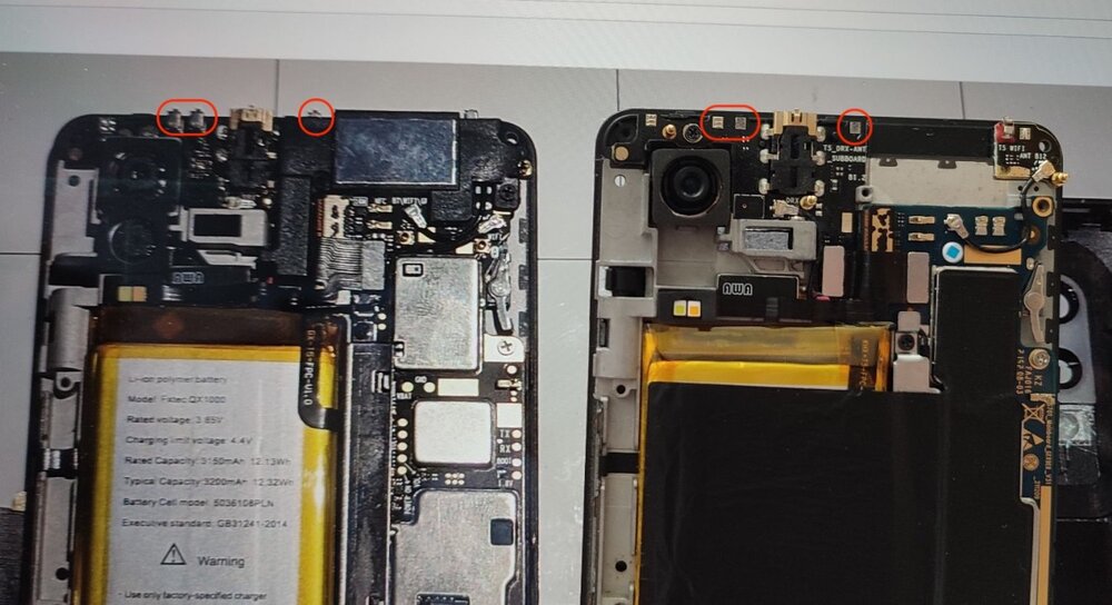

On 7/15/2023 at 2:03 AM, Jormsen said:
As it seems to be hardware issues i wonder if it has something to do with missing connection springs.
Is it only my device looking like this?
Can't find a seller for these, the closest contacts i can find are these:
OGSC-T-302020 https://www.kitagawa.de/wp-content/uploads/OGSC-TB-302020-1.pdf
SImilar for me.  I have one of the springs that you're missing:
I will try using a small bit of metallic tape to bridge the presumed connection to case edge.  Will report back.

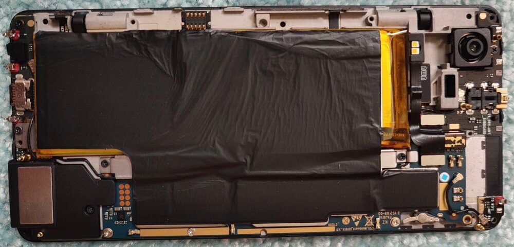

Yeah, I don't know.  Hard to say if it made a connection, but in the attempt the spring that I have that @Jormsen did not have fell off.  What a piece of trash.
I held a wire to the other spring under the GPS and that seems to positively affect my 5GHz signal.  FWIW.
