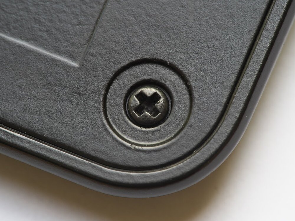

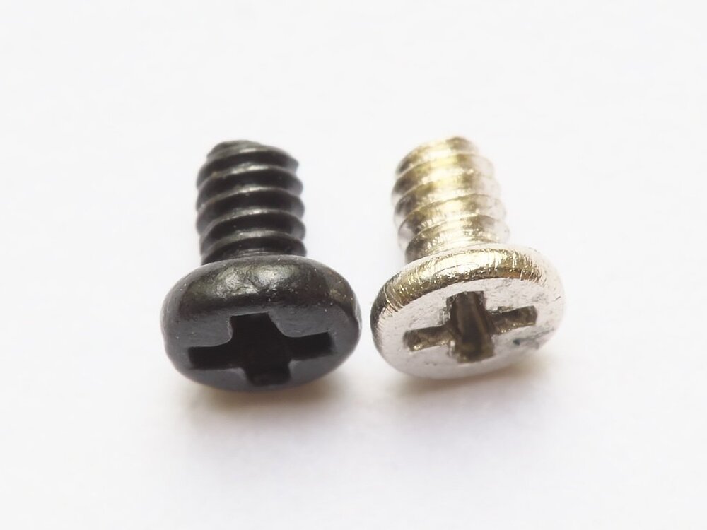

VaZso 1,999 Posted September 2, 2021 Share Posted September 2, 2021 On 8/20/2021 at 4:39 PM, VaZso said: Okay, maybe this one is different (I mean better than the above). 🙂 I have bought it and it has a perfect fit (original is silver and this is black in the following photos). ...and in place: So if someone would like to buy replacement screws, I recommend buying from the link above and the correct details are "M1.4 + 2mm" and 100PCS are to be sold currently at $3.38 3 3 Quote Link to post Share on other sites
