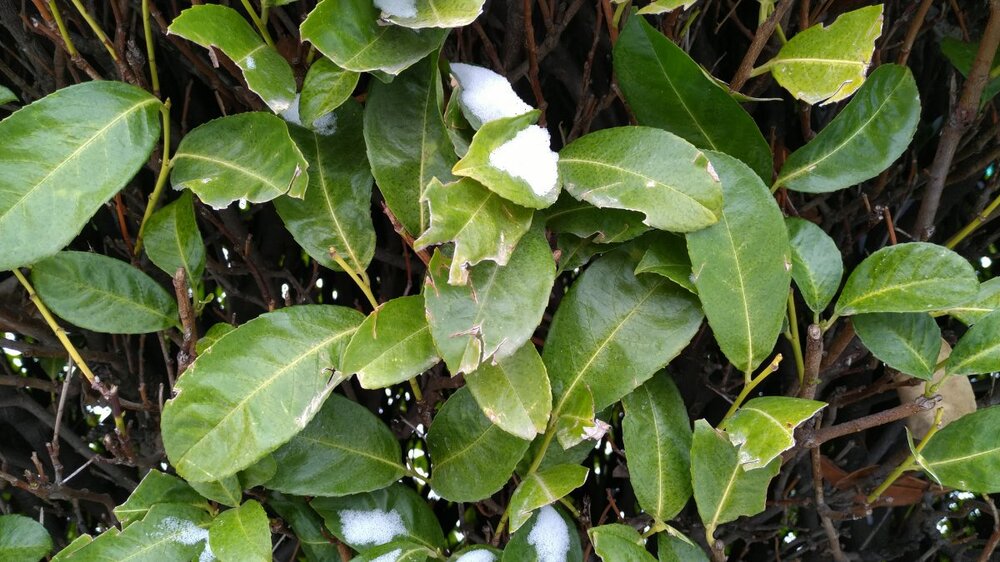

Jordi 72 Posted February 13, 2021 Share Posted February 13, 2021 This is what I get, when doing something similar, everything is evenly blurred. Note that the focus is correct for close-up objects. Quote Link to post Share on other sites

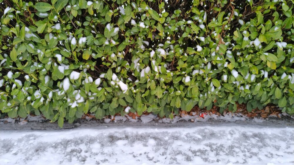

Longcat 34 Posted February 13, 2021 Share Posted February 13, 2021 Hoping to balance the negativity in this thread, my F(x)tec Pro1 running LineageOS does not seem to have any camera issues regarding focus (see the attached sample I took today). Running LineageOS 18.1 (unofficial; 20210105), using a Google Camera version (though I forgot exactly which one). 3 3 Quote Link to post Share on other sites

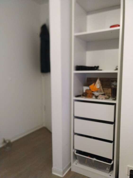

__fastcall 97 Posted April 4, 2021 Share Posted April 4, 2021 (edited) Hey, just flashed Lineage 18 and it's as bad as before. I can't make a real clear picture with the phone at all. The edges are all just blurred. I begin to wonder if it's a hardware issue. Auto Focus is barely doing anything useful and manually focusing (With OpenCamera) also never gets me a sharp photo. Never tried the stock rom as everyone said not to bother with it. I'm going to shoot the support a message. I've waited a year patiently in hopes of a solution. Maybe it helps to bring up awareness again. Front camera works fine, it's just the back camera. Maybe the phone fell too hard on something and broke the camera? I just want to make some pictures.. 😄 Attached a photo, this is basically the best I could get out of the phone today.. Edited April 4, 2021 by __fastcall 1 Quote Link to post Share on other sites
VaZso 1,999 Posted April 4, 2021 Share Posted April 4, 2021 27 minutes ago, __fastcall said: Never tried the stock rom as everyone said not to bother with it. If it is possible for you, I would try to temporarily install stock OS and test the camera there. That would give a real answer if it is a hardware failure or not. It was not clear for me if camera quality is generally good under LineageOS or not and if it isn't, GCam port helps or not... 1 Quote Link to post Share on other sites
__fastcall 97 Posted April 4, 2021 Share Posted April 4, 2021 3 minutes ago, VaZso said: If it is possible for you, I would try to temporarily install stock OS and test the camera there. That would give a real answer if it is a hardware failure or not. It was not clear for me if camera quality is generally good under LineageOS or not and if it isn't, GCam port helps or not... I really would rather not to as I don't want to lose my configuration/apps and do the whole setup again. Or is it possible to basically copy the whole harddisk and revert later on? I had better results with these GCam ports, but I usually made photos outside. They seem to be much sharper. I was shocked to find out that close objects seem to be blurred completely.. Quote Link to post Share on other sites
Rob. S. 1,667 Posted April 5, 2021 Share Posted April 5, 2021 16 hours ago, __fastcall said: Attached a photo, this is basically the best I could get out of the phone today.. Surely looks like a defective camera to me. There's no way a phone camera with its huge depth of field could render one corner halfway sharp (bottom right) while blurring the rest of the image if there wasn't something bent out of shape in it. Quote Link to post Share on other sites
claude0001 1,424 Posted April 5, 2021 Share Posted April 5, 2021 (edited) 21 hours ago, __fastcall said: Attached a photo, this is basically the best I could get out of the phone today.. Looking at your picture, I notice that the lower right corner is actually sharp: that wall socket seems to be quite nicely in focus. The rest of the picture obviously isn't -- even though there are many objects at roughly the same distance from the lens than the wall socket. Also the upper half of the shelf exhibits some very strange ("wavy") perspective distortion. This looks like an optical problem. Like a misalignment between lens and sensor or so. Sadly, I do not think this can be corrected for in software. @Jacob_S posted similarly distorted pictures earlier in this thread. Maybe they have found out more about the problem by now ... Edit: Just realised @Rob. S. have come to the same conclusion about your picture. I can only agree with them. Edited April 5, 2021 by claude0001 2 Quote Link to post Share on other sites
