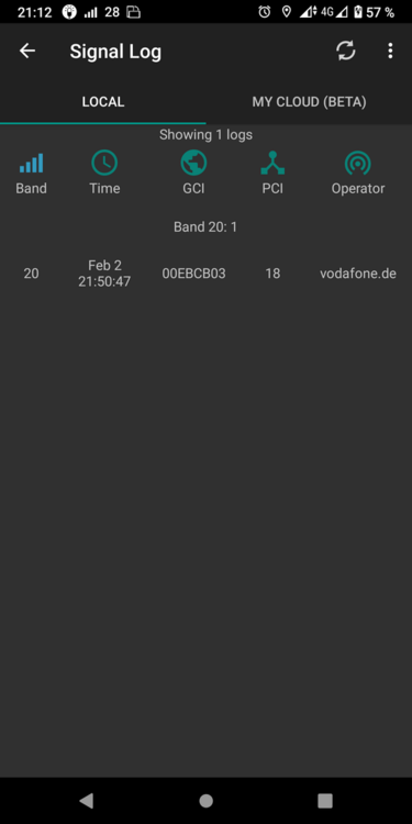

Germany without 3G here, too, Vodafone and T-Mobile SIMs: LTE frequently drops on both SIMs, so no good internet, but voice is no problem, both incoming at outgoing calls work well enough so far.

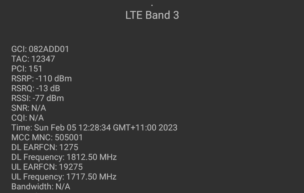

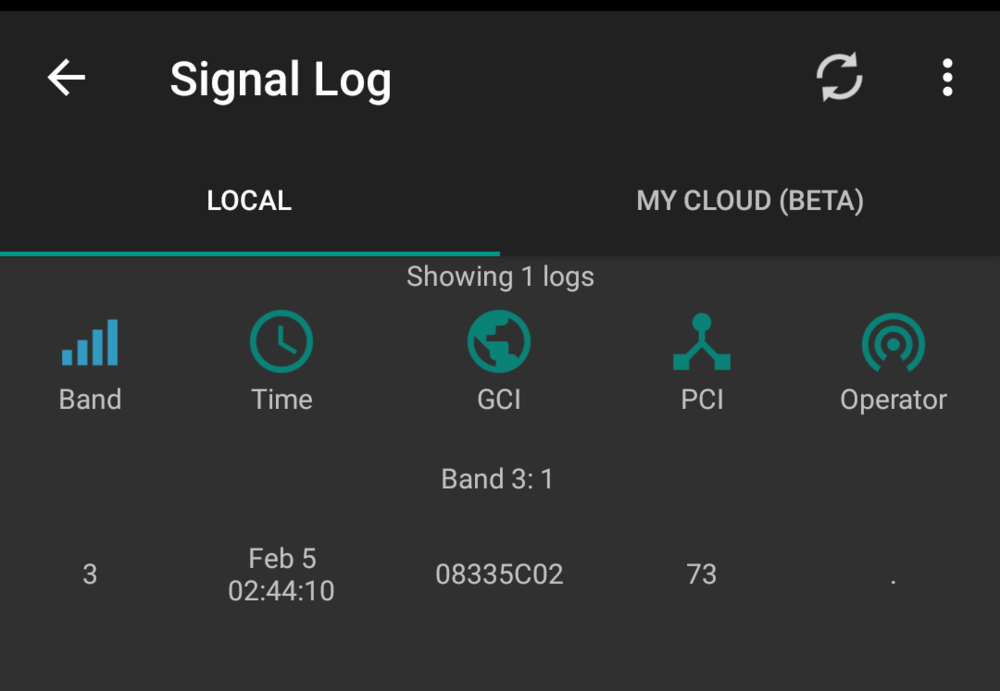

If I interpret the dumps here correctly, band 3 seems to be related to the problem.
In Australia with my provider, according to documentation band 3 is
3G: 850MHz, 2100MHz
4G/LTE: 1800MMHz
Here are the details in a screenshot
This seems to match what @FlyingAntero said in an earlier post here:
Edited by doubleddav
That would consistent with my observation earlier, LTE band 3 had issues even with very good signal levels.

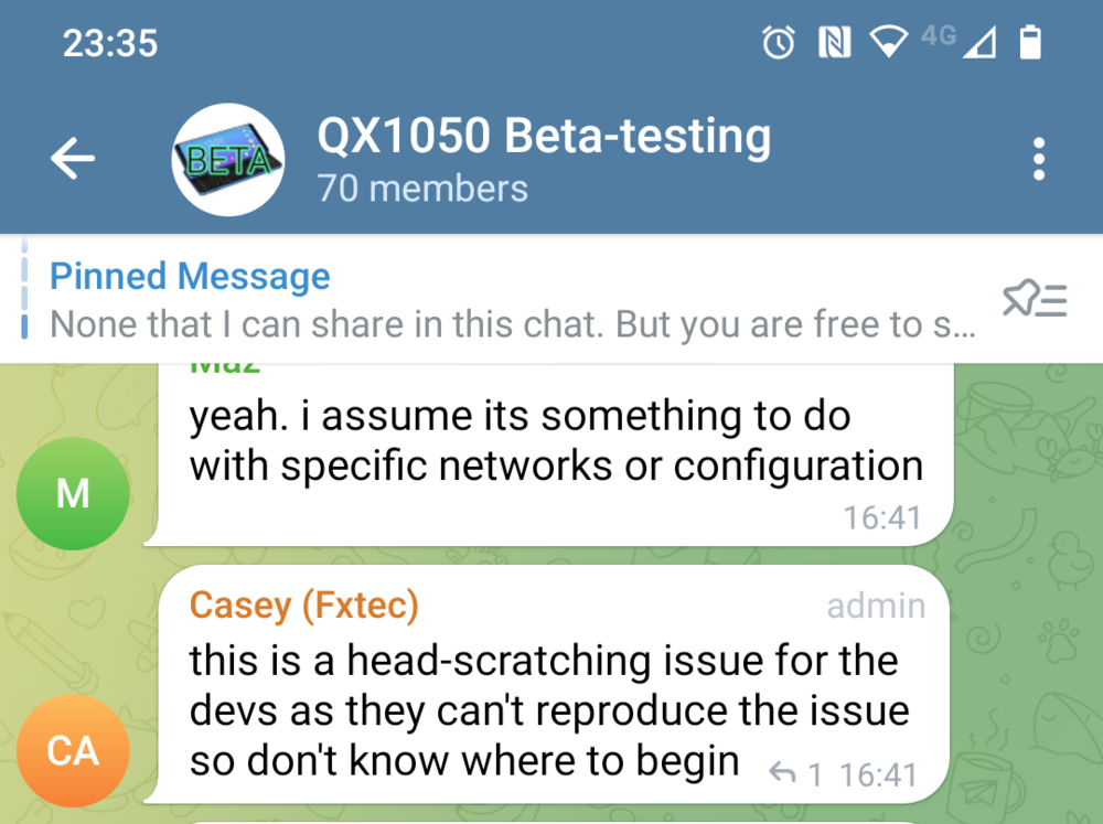

in my eyes at least, U pulled together several comments & came to a conclusion, that seems 2B worthy of consideration by those who have the ability to improve Pro1x 'stock' OS &/or firmware.
Right now, my Pro1x is little better than a v.v. expensive toy or prototype: it is too unreliable at recieving calls; I can't trust it to work as a phone, which is what it is marketed as! And if F(X)tec don't put this right, & soon, the company and the project will FAIL - which will be a massive disappointment.
I don't believe anyone here wants to see that happen, but it will if they don't get their act together, and quickly.  And that's why I posted your comment as I did, in the hope that it would be seen by those can and need to step up to the challenge and make the difference!!

Thanks everyone for trying to shed some light on this severe issue. Unfortunately I cannot provide data until I find a way to report modem usage in (Gapps-free) LineageOS. Discover LTE does not work for me for the reasons discussed.
Meanwhile, I have taken my Pro1X on a few trips across Germany. Its LTE/VoLTE reliability is catastrophic all around. Even with a theoretically good connection (> -100 dBm) there is usually no Internet service. I gave up testing GSM (i.e. non-VoLTE) calls as they have never worked for me, even with working LTE (data) connection. Side note: My (835)Pro1, while far from stellar in its connectivity, did perform acceptably in all cases.
Sadly, as F(x)tec have reportedly been working on this issue for months with no tangible result, I fear that this is a hardware issue that is essentially unresolvable from the software side ...
Edited by claude0001

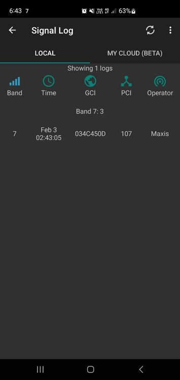

Hi, I'm living in Malaysia.
I'm also facing unstable connectivity issue on Band3/7 with my Pro1X.
My finding is when I traveled to Thai last week, connectivity was OK.
At that time, I didn't check which Band was connected, but it seems Band1 is common in Thai.
Besides, I'm checking Japanese BBS about Pro1/Pro1x recently.
No one report connectivity issue as far as I know.
Band1 is common in Japan as well.
  • Thanks 2
Link to post
Share on other sites
Did you experience band switching like mine? I am in Malaysia too
  • Like 1
  • Thanks 1
Link to post
