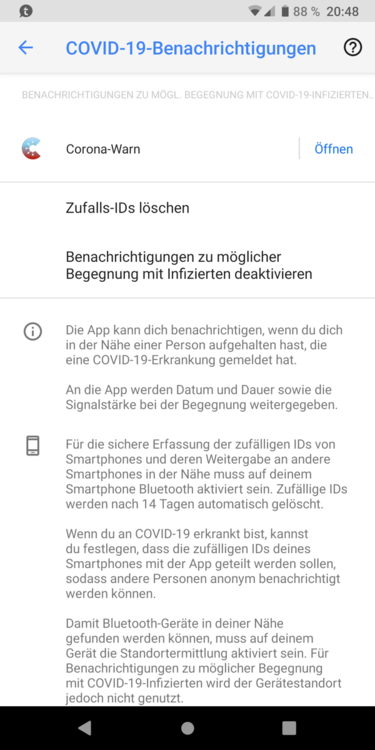

EvilDragon 164 Posted June 17, 2020 Share Posted June 17, 2020 Maybe someone here knows: I´ve installed the official Corona warn app from german government which uses the new expose notification framework from Google (implemented in play services 17.x and higher - I´m running the latest 20.x version). However, it complains that it can´t find the api - and the same seems to happen for all Xiaomi users. Does anyone know what´s missing here? Is this something that can even be fixed with an OS like Lineage? Quote Link to post Share on other sites

tdm 2,322 Posted June 17, 2020 Author Share Posted June 17, 2020 6 hours ago, EvilDragon said: Maybe someone here knows: I´ve installed the official Corona warn app from german government which uses the new expose notification framework from Google (implemented in play services 17.x and higher - I´m running the latest 20.x version). However, it complains that it can´t find the api - and the same seems to happen for all Xiaomi users. Does anyone know what´s missing here? Is this something that can even be fixed with an OS like Lineage? Apparently the German corona-warn-app is only available from Play Store in Germany (known issue on github), so I installed it from apkmirror (here). It installs and starts fine on my device using test13 and Play Services 20.18.17. Is there a particular function in the app that fails? Quote Link to post Share on other sites

EvilDragon 164 Posted June 17, 2020 Share Posted June 17, 2020 1 hour ago, tdm said: Apparently the German corona-warn-app is only available from Play Store in Germany (known issue on github), so I installed it from apkmirror (here). It installs and starts fine on my device using test13 and Play Services 20.18.17. Is there a particular function in the app that fails? Hm, I'm getting the error: "CAUSE: 3 Something went wrong Error when communicating with Google API(17)" Details say: "Nearby.EXPOSURE_NOTIFICATION_API is not available on this device. Connection failed with: a(statusCode=UNKNOWN_ERROR_CODE(39507), resolution=null,message=null)" and a lot more stuff. That happens right after installation when it tries top open the API. I'm on Google Play Services 20.21.15, so it's even more recent than yours. Hm, maybe it's some of the Google stuff I froze (Google Partner Setup?) - but, hey, flashing test13 did remove my root (even though it's enabled in the developer settings), so I guess I need to reinstall su first 🙂 Quote Link to post Share on other sites
Wheeljack 212 Posted June 17, 2020 Share Posted June 17, 2020 (edited) Corona-Warn is working for me. I´m on Play Services 20.21.17 Google-App is 11.14.6.21.arm64 lineage test13 - not rooted Trust data protection is deactivated for Google and Play-Services That´s about it what I believe could be different on your Pro1. Edit: do you see the Corona options under Settings -> Google ? Edited June 17, 2020 by Wheeljack Quote Link to post Share on other sites

EvilDragon 164 Posted June 17, 2020 Share Posted June 17, 2020 3 hours ago, Wheeljack said: Corona-Warn is working for me. I´m on Play Services 20.21.17 Google-App is 11.14.6.21.arm64 lineage test13 - not rooted Trust data protection is deactivated for Google and Play-Services That´s about it what I believe could be different on your Pro1. Edit: do you see the Corona options under Settings -> Google ? Nope, I don´t even have the settings, they don´t pop up. Hm, maybe I´ll reset to factory settings. Never did that since intalling my first LineageOS build... I always simply upgraded. Quote Link to post Share on other sites
Wheeljack 212 Posted June 18, 2020 Share Posted June 18, 2020 Which gapps did you install? Quote Link to post Share on other sites
EvilDragon 164 Posted June 18, 2020 Share Posted June 18, 2020 (edited) 9 hours ago, Wheeljack said: Which gapps did you install? The ones that are linked directly from tdm´s download page. EDIT: So basically MindTheGapps. But yes, I can try reinstalling them. Edited June 18, 2020 by EvilDragon Quote Link to post Share on other sites

EvilDragon 164 Posted June 19, 2020 Share Posted June 19, 2020 Okay, did the update and think I fixed most of the issues. The Corona App did work after I manually updated the Google Play Services using the latest APK from apkmirror. No idea, why it didn't work before though, probably a bug in the Play Services version I was using. Additionally, I reinstalled supersu - which made the AudioDAC Booster work again. I do remember that I installed this as someone suggested that this can fix some audio issues - so this probably was what fixed the WhatsApp issue I had (I need to check and confirm this though). If that's the case, then there's a bug with the current LineageOS version which could be fixed by checking what the AudioDAC Booster does :) Finally, at least for me, the keyboard is still not correct: Fn + L now produces # instead of ' So it has changed, but it's still not correct (unless I did something wrong). 1 Quote Link to post Share on other sites
