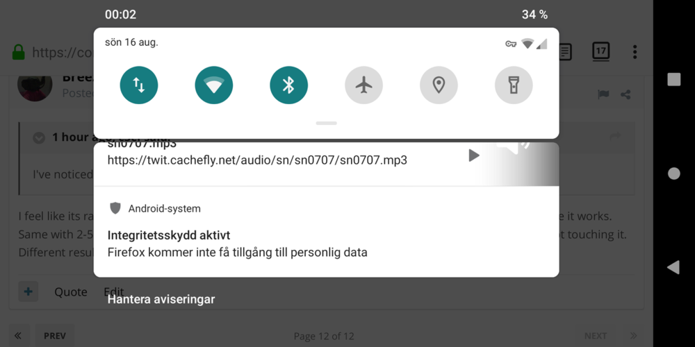

Breeze 26 Posted August 15, 2020 Share Posted August 15, 2020 Another stupid non adroid user quetion. Why do i have this everytime i have an app open? This Android protection notification? (here it is FireFox) I can only snooze it, then it comes back 1 Quote Link to post Share on other sites
tdm 2,322 Posted August 15, 2020 Author Share Posted August 15, 2020 1 hour ago, Breeze said: Another stupid non adroid user quetion. Why do i have this everytime i have an app open? This Android protection notification? (here it is FireFox) I can only snooze it, then it comes back I believe this is privacy guard. Try: "Settings->Privacy->Privacy Guard->Show notification" Quote Link to post Share on other sites
Breeze 26 Posted August 15, 2020 Share Posted August 15, 2020 16 minutes ago, tdm said: I believe t🍻his is privacy guard. Try: "Settings->Privacy->Privacy Guard->Show notification" Looks like it solved the "problem". These sub, sub , more sub menus 🧐 Sitting by the computer now and gonna send some beer money 🍻 Only thing I miss now is support fot full Finnish/Swedish keyboard layout (swdish and finnish has the same). Cant find @ on the keyboard, have to use virtual keyboard for that. Thanks mate 😀 1 1 Quote Link to post Share on other sites

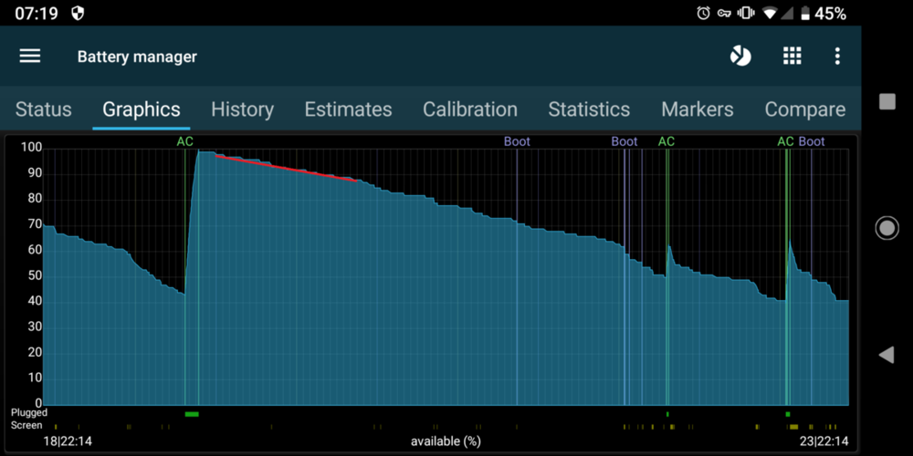

EskeRahn 5,598 Posted August 16, 2020 Share Posted August 16, 2020 On 8/13/2020 at 10:02 PM, EskeRahn said: a better estimate of the idle consumption than my previous claim that it was about 1%/h, it really is only about 0.5%/h Just for info and off topic this is not LineageOS only, the same goes for Stock. Below an example from July 19th, with very little usage, where it dropped 10% in 20½h (red line) Quote Link to post Share on other sites
