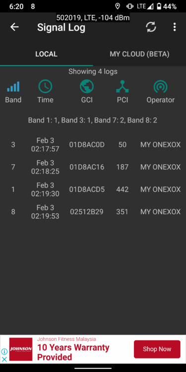

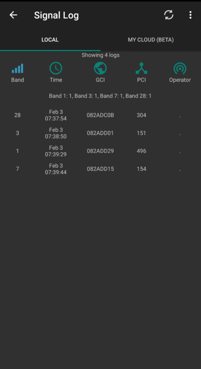

The 1.8 GHz band is certainly important in Germany. According to this Wikipedia page, my carrier (O2) is using it for LTE and GSM.
Interestingly, up to now I've never been able to initiate or receive a GSM call (i.e. with VoLTE disabled), even in one of those lucky spots where LTE (and VoLTE) works.
Is there any app that can display what frequency bands are being used by the modem in real time?
...Or even better if it could log what is used and when any switches occurs. That info could certainly help in confirming (or disproving) the interesting theory of @FlyingAntero
We know that at the least some antennas were redesigned for the Pro1X, so it could make sense if that have affected different bands in different ways. And if we are lucky they can turn the power up on specific antennas and still stay within what they are legally allowed to.
Re-reading this thread, I found that in one of their posts, @Rasva suggested an app named "LTE Discovery" that seems to do exactly that. I'll try it once I'm back with the prawn-X.
I'm currently doing this on Sailfish with Cellmon in Australia.
One thing I have noticed is that I'm seeing a swap between 4G and 3G which IIRC I wasn't without Cellmon, It stayed purely on 4G or nothing. I'll test that later.

Yes, LTE discovery does +/- this, you have to enable overlay, so it shows you signal level over the other apps. But in free version the overlay will not show channel number, only signal level and operator name. For the channel number you will have to go to the app itself.
Also another problem - this app does not work under Lineage, at least for me. It says "no active cells detected"
