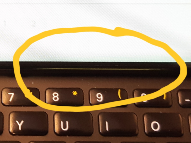

DieBruine 397 Posted February 25, 2020 Share Posted February 25, 2020 (edited) My display has started bleeding between nr 7 and -_ . This started about a week ago. Looks like the adhesive is letting go on the edges. I am as of yet unable to show you this because for some unknown reason the pictures I upload won't show correctly. Tried converting to other formats and resizing to no avail... Edited February 25, 2020 by DieBruine Sure, now it works... 2 Quote Link to post Share on other sites
